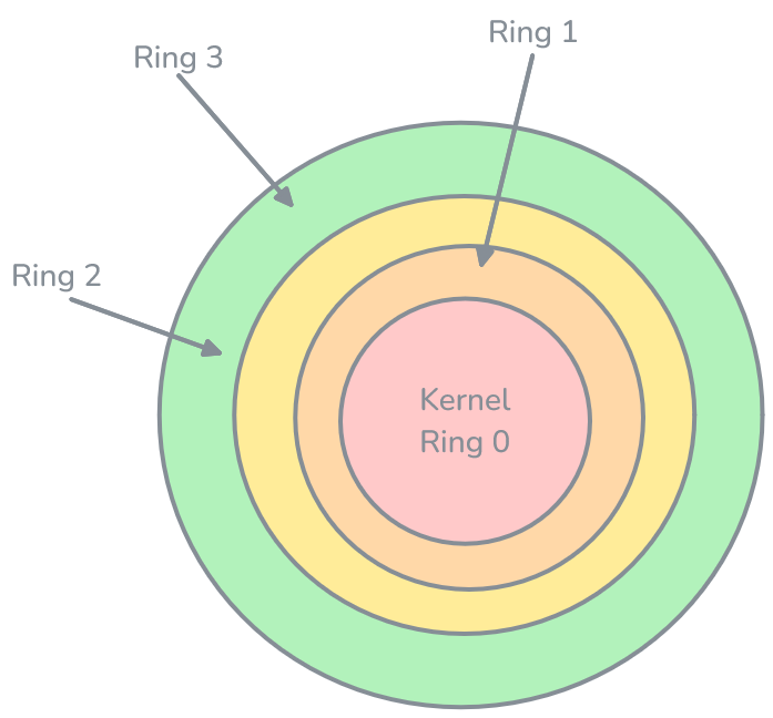

──[ 0. Windows Privilege Rings ]──
Windows split execution into privilege levels called rings. Each ring is
isolated and can only reach lower-privilege rings through well-defined channels
(APIs, syscalls, drivers, callbacks).
graph TD
    R0["Ring 0 — Kernel Land\n(ntoskrnl, drivers)"]
    R3["Ring 3 — User Land\n(applications, browsers, Office…)"]
    R0 <-->|"Win32 API / syscalls"| R3
Windows privilege rings
User Land (Ring 3) — where normal apps live. Memory isolated per
                          process. Kernel can kill anything.
    Kernel Land (Ring 0) — Windows core, device drivers, EDR kernel pieces.
                           Code has full access: all memory, all devices.
Going from Ring 3 to Ring 0 legitimately means loading a signed kernel driver.
