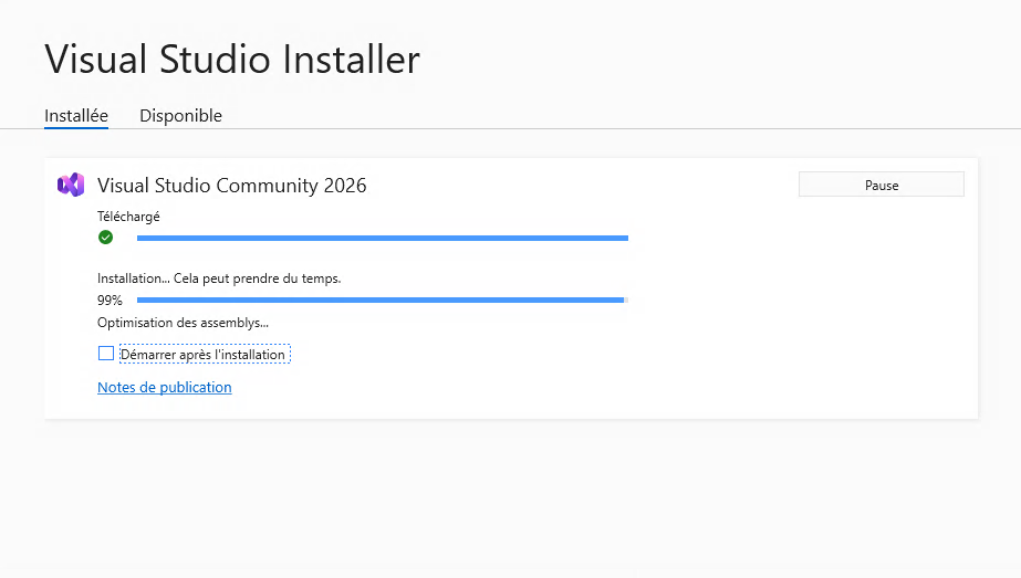

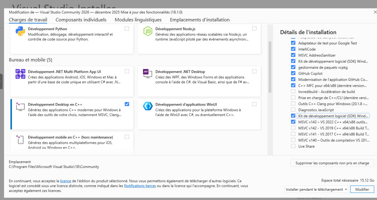

Visual Studio 2022
    Microsoft's standard IDE. During setup, pick:
    "Desktop Development with C++"
    Then add these individual components:
        MSVC v143 — VS 2022 C++ x64/x86 Spectre-mitigated libs
        MSVC v143 — VS 2022 C++ ARM64/ARM64EC Spectre-mitigated libs
        C++ ATL for latest v143 build tools with Spectre (x86 & x64)
        C++ ATL for latest v143 build tools with Spectre (ARM64/ARM64EC)
        C++ MFC for latest v143 build tools with Spectre (x86 & x64)
        C++ MFC for latest v143 build tools with Spectre (ARM64/ARM64EC)
        Windows Driver Kit
Visual Studio — individual components selection
Visual Studio — installation in progress

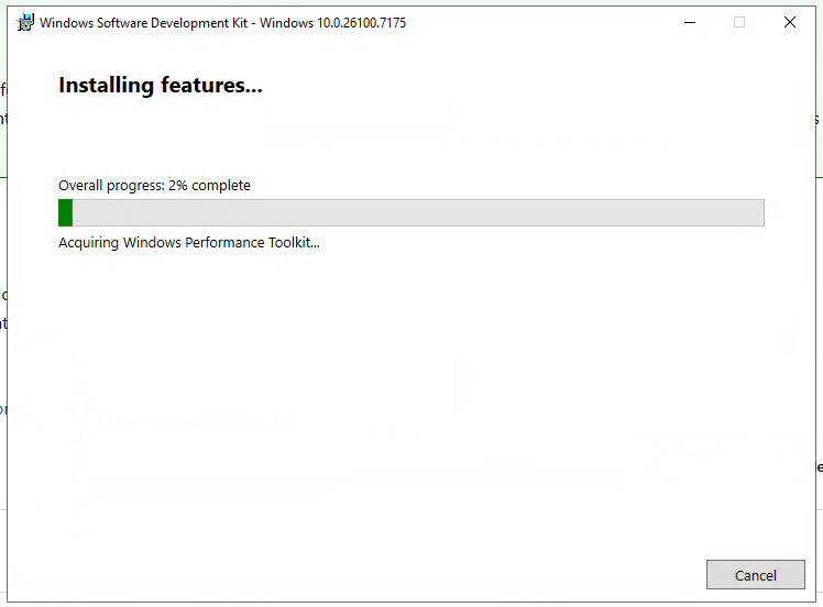

Windows SDK
    Goes with the WDK. ~3.5 GB. Install it before the WDK.
Windows SDK — installer

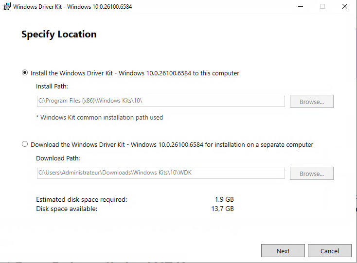

Windows Driver Kit (WDK)
    ~2 GB. Kernel headers, libs, driver build system. Needs Visual Studio
    and the SDK installed first.
WDK — installer

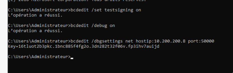

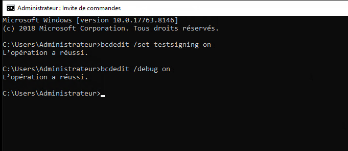

Test Signing Mode
    Windows refuses unsigned drivers by default (DSE). Test signing lets
    you load self-signed or unsigned drivers:
        bcdedit /set testsigning on
Note: Secure Boot has to be off first — test signing and Secure Boot
    don't cohabit (see the ELAM article for why).
Kernel Debug Output
    Drivers write debug output via KdPrintEx(). To see it, enable kernel
    debugging:
        bcdedit /debug on
bcdedit — debug mode enabled output

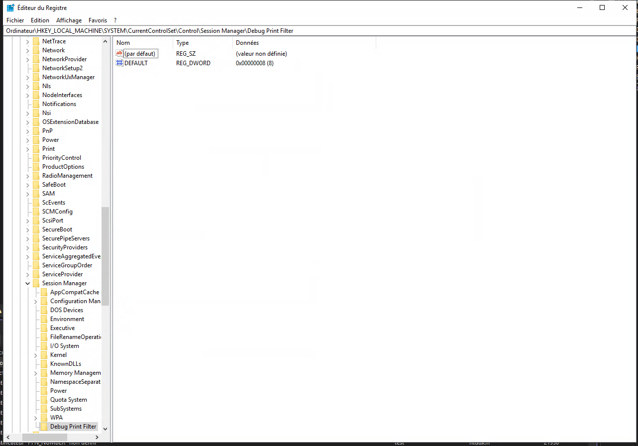

Then create the debug filter in the registry:
        Registry key: HKLMSYSTEMCurrentControlSetControl
                      Session ManagerDebug Print Filter
        New DWORD:    DEFAULT = 8
Registry — Debug Print Filter DWORD set to 8

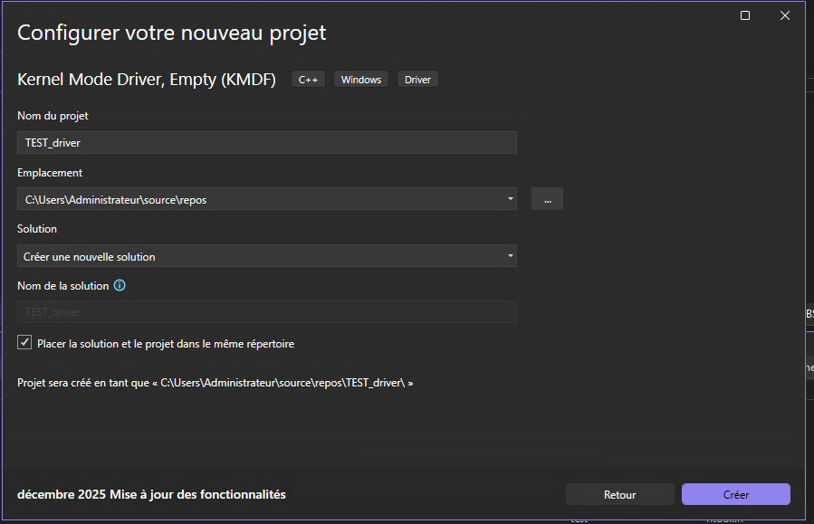

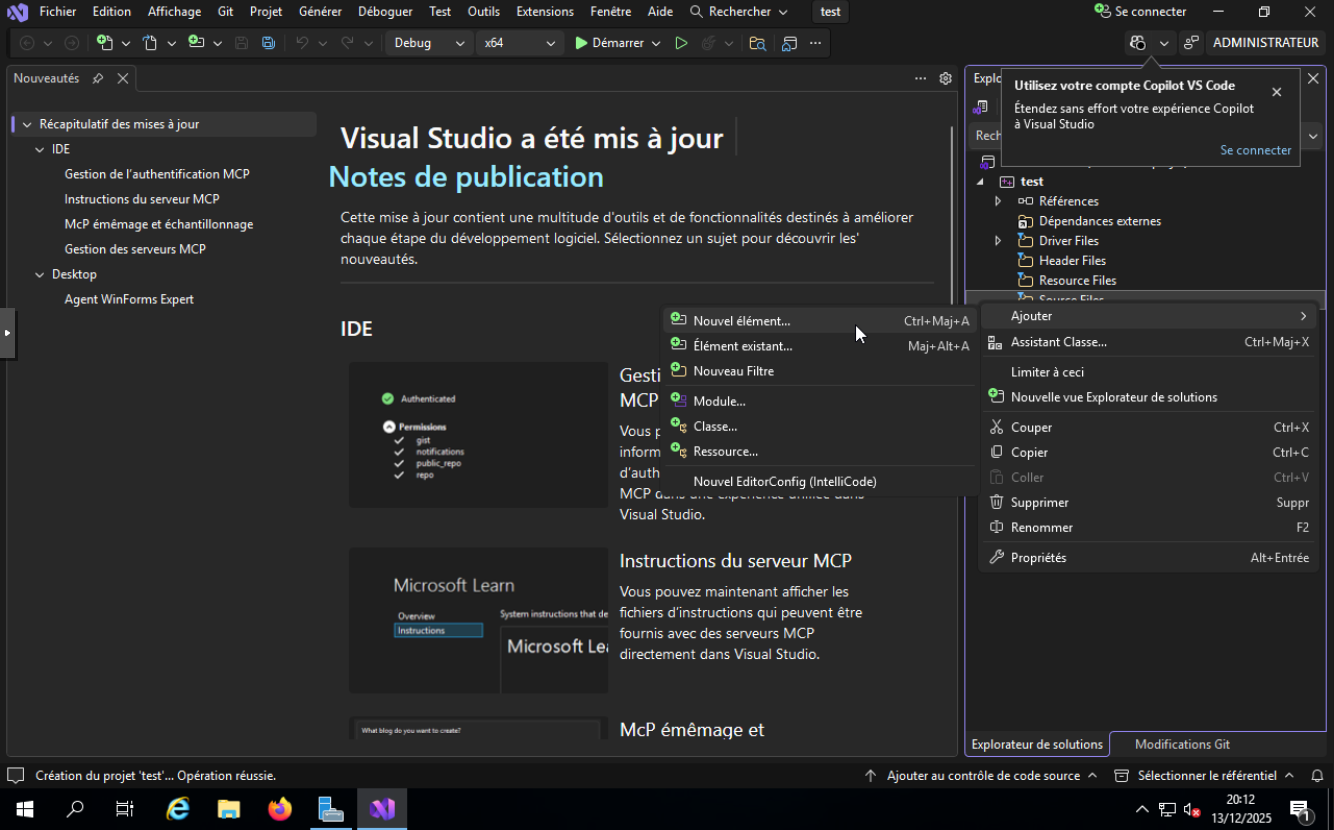

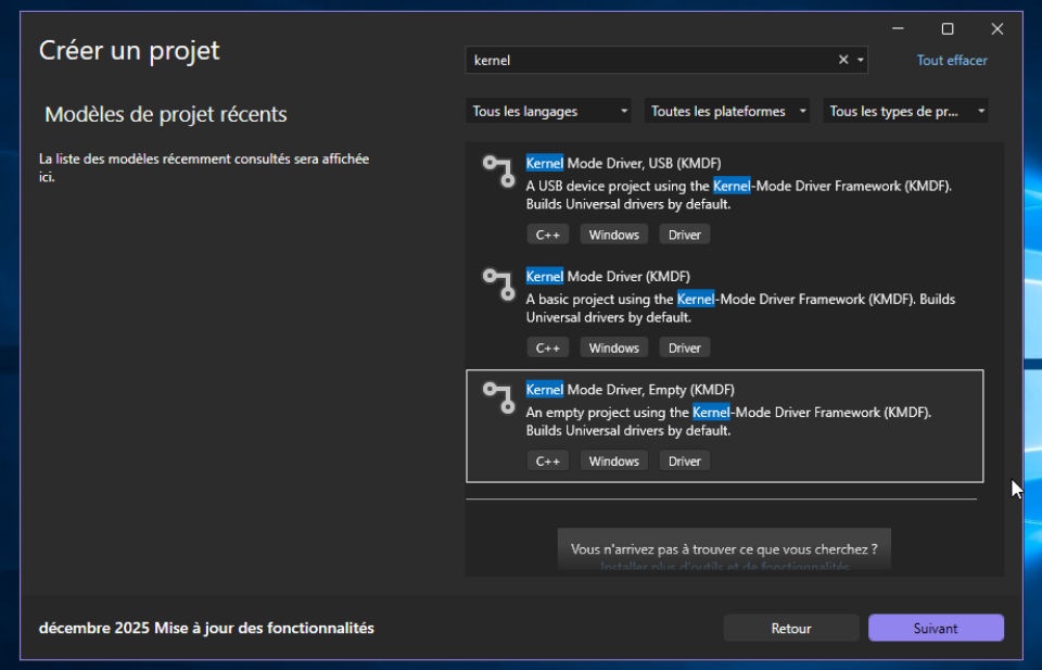

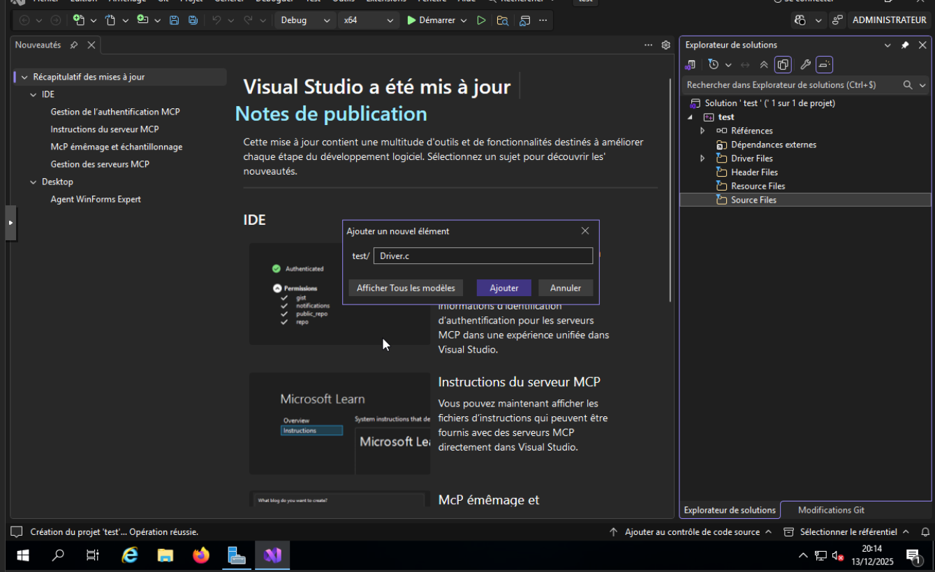

Create a new KMDF driver project in Visual Studio, add a .c source file.
Visual Studio — new KMDF driver project dialog
Visual Studio — project creation wizard (step 2)
Visual Studio — add new .c source file
Visual Studio — .c file added to project

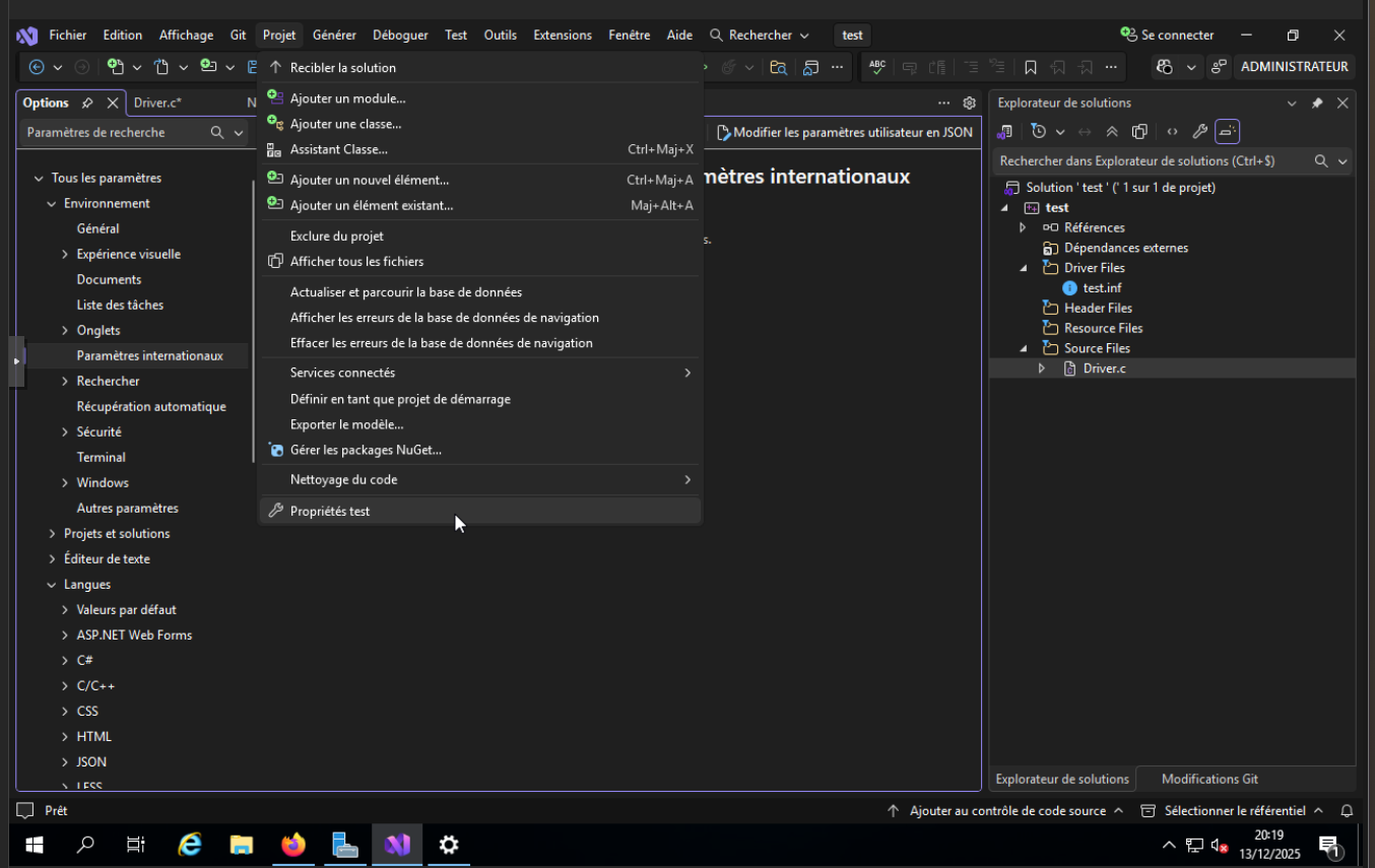

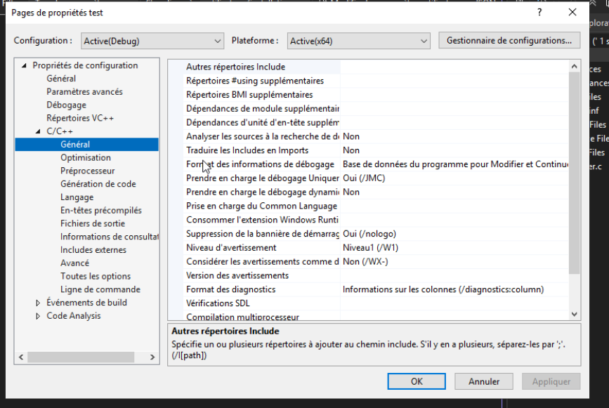

If ntddk.h isn't found, add the include path manually:
    C:Program Files (x86)Windows Kits10Include<build>km
VS — additional include directories config
VS — include path added

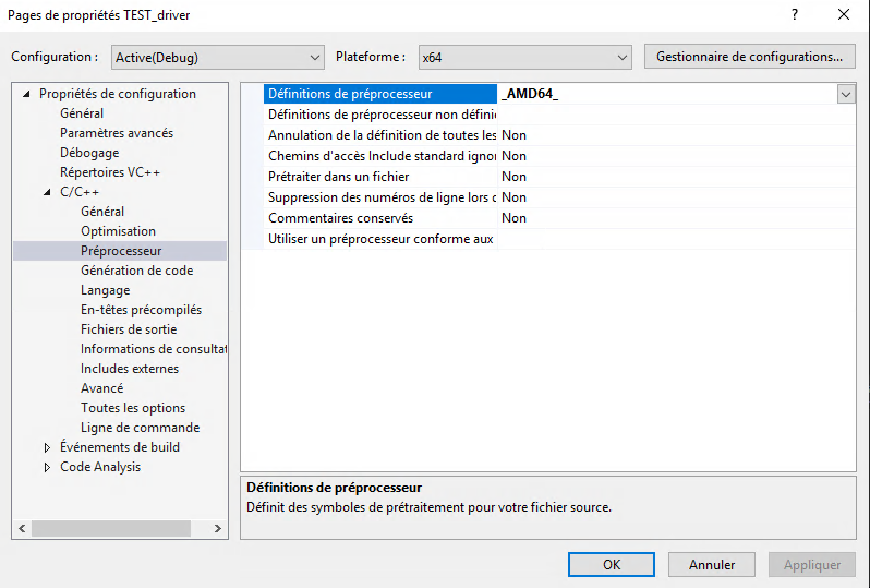

            WDF_NO_OBJECT_ATTRIBUTES, &hDevice);
        return status;
VS — preprocessor definitions (KMDF config)

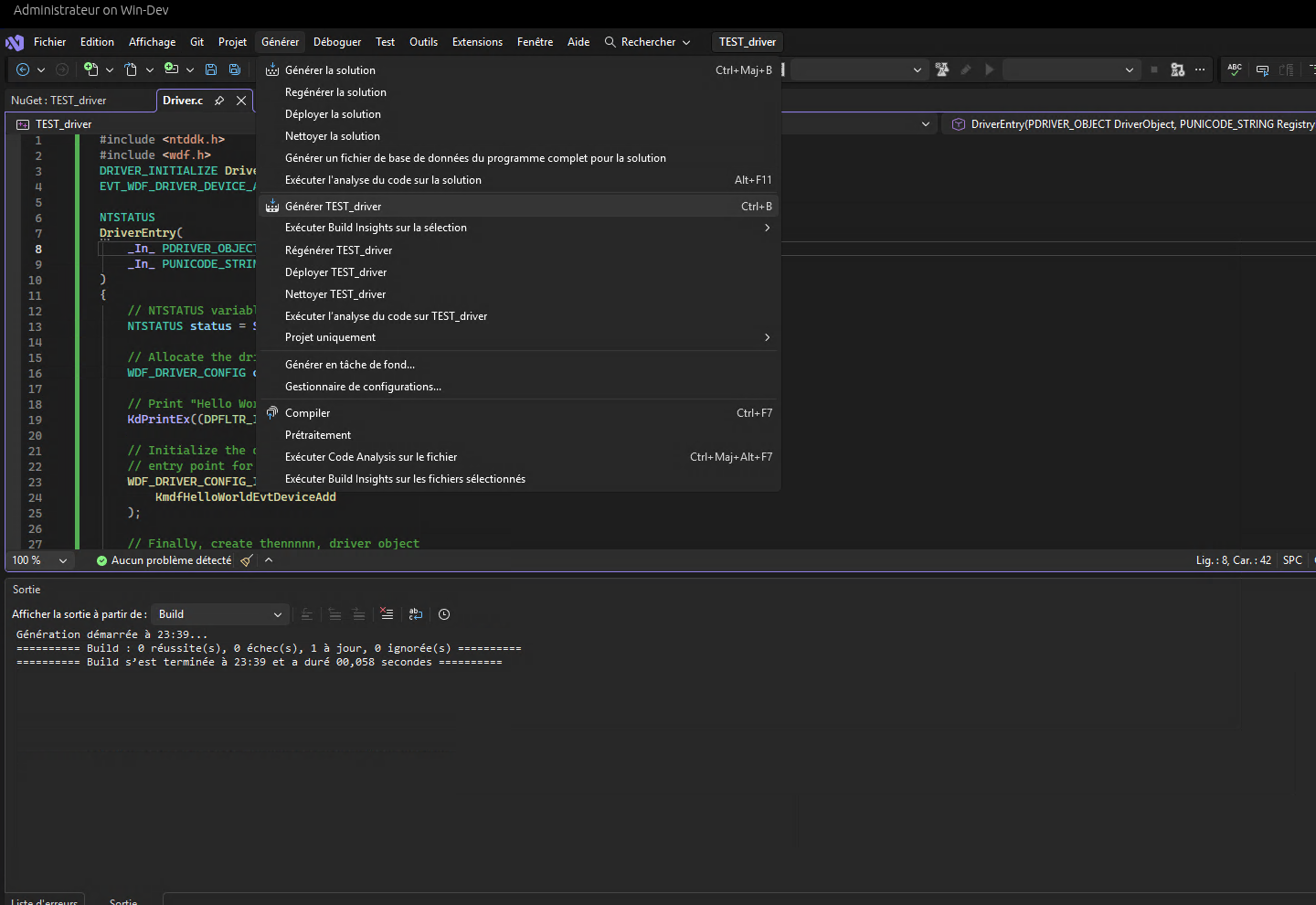

Build: Build → Build Solution in Visual Studio.
VS — Build Solution menu

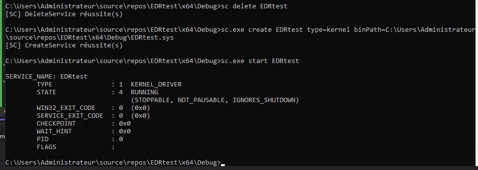

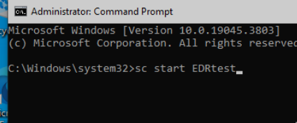

Load via Service Control Manager (admin terminal):
    sc.exe create MyDriver type=kernel binPath="C:\path\to\driver.sys"
    sc.exe start MyDriver
sc.exe — driver loaded and started
Unload:
    sc.exe stop MyDriver
    sc.exe delete MyDriver

    Same bcdedit commands as step 2, plus the network target:
        bcdedit /dbgsettings net hostip:<HOST_IP> port:50000

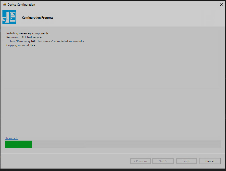

Install the WDK test target MSI on the target:
        "C:\Program Files (x86)\Windows Kits\10\Remote\x64\
         WDK Test Target Setup x64-x64_en-us.msi"

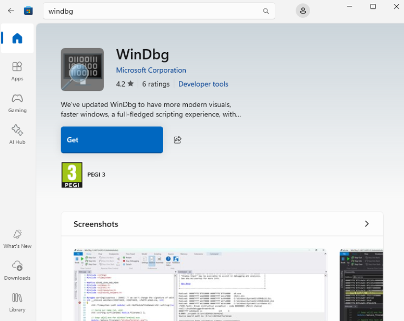

    Install WinDbg from the Microsoft Store.

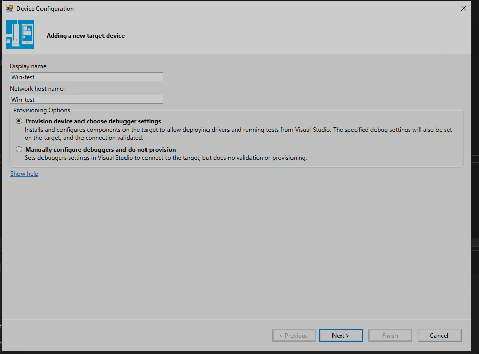

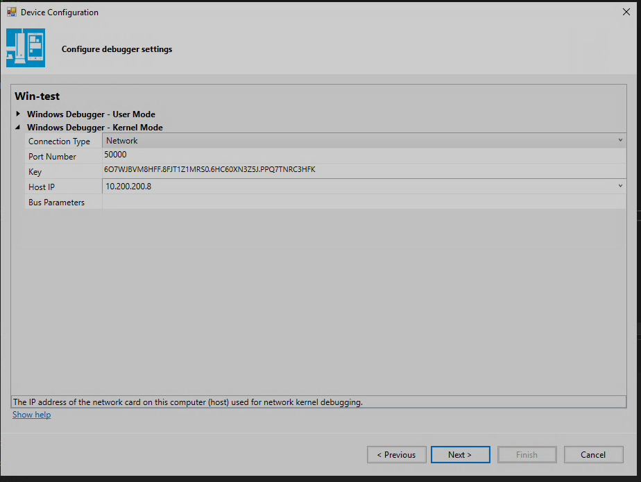

    Configure the remote debugging target in Visual Studio.
VS — remote debugger target configuration (step 1)
VS — remote debugger target configuration (step 2)
VS — remote debugger target configuration (step 3)
Hook WinDbg up to the target over the network.

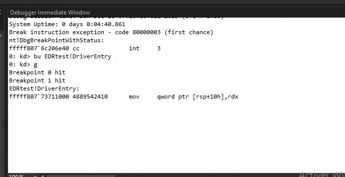

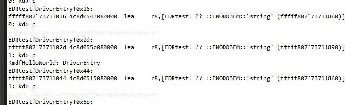

    bu MyDriver!DriverEntry     Breakpoint on DriverEntry
    g                           Continue until next breakpoint
    t                           Step Into (enters called functions)
    p                           Step Over (skips called functions)
    lm                          List loaded modules
    !process 0 0                List all processes
    db <addr>                   Dump bytes at address

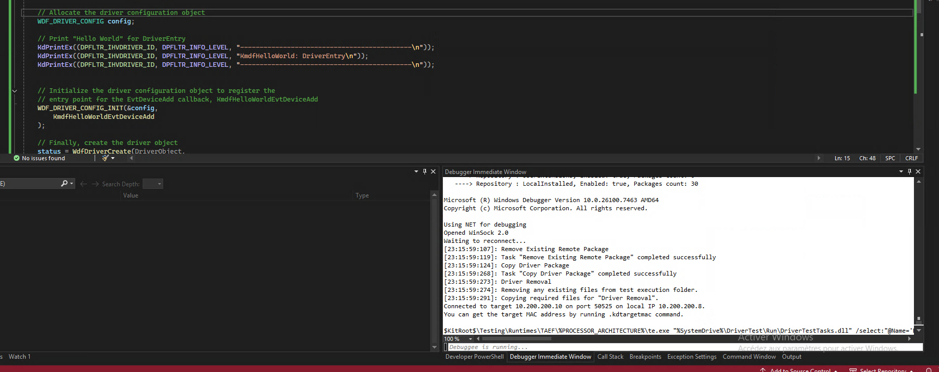

WinDbg — waiting for process launch (run and hit breakpoint)
WinDbg — stopped at DriverEntry breakpoint
WinDbg — debugging indicator active

    T->>W: KdPrintEx output visible
Once the debugger is attached you can pause the target kernel, inspect registers
and memory, and step through your driver code instruction by instruction.
WinDbg — KdPrintEx output visible after stepping
