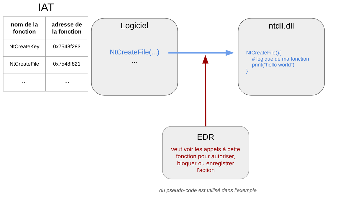

DLL hooking is how EDRs intercept Win32 API calls. When a hooked function gets
called, execution detours through the EDR's code before (or instead of) reaching
the real one. The EDR correlates the call with process context, flags suspicious patterns,
logs the event. Two canonical examples:
    notepad.exe writes to a file       — normal, ignored
    notepad.exe spawns cmd.exe         — suspicious, flagged
Two main hooking techniques in the wild.

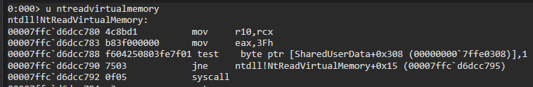

On disk the DLL is untouched (and signed — the kernel won't load a modified
signed DLL). The hook only exists in memory. NtReadVirtualMemory — clean prologue (on disk):
    4C 8B D1        MOV R10, RCX
    B8 3F 00 00 00  MOV EAX, 0x3F
NtReadVirtualMemory — clean assembly (on disk)
NtReadVirtualMemory — hooked (in memory):
    E9 XX XX XX XX  JMP <EDR function>
NtReadVirtualMemory — hooked (JMP as first instruction)
Every call to NtReadVirtualMemory jumps into the EDR unconditionally.

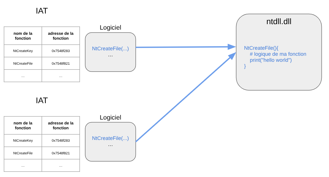

──[ 3. IAT Hooking ]──

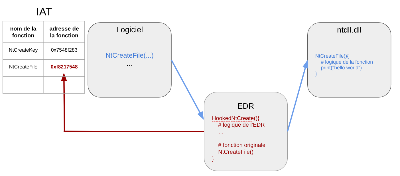

The Import Address Table (IAT) is a per-module table of function pointers. When
your exe calls MessageBoxA, it reads the pointer from its IAT and jumps. The IAT
gets filled in by the loader at startup. IAT hooking swaps a pointer in this table for the EDR's function address. Only
the module whose IAT is patched is affected; other processes aren't (unlike
inline hooking, which patches the shared in-memory DLL).
    Before hooking:
        IAT[MessageBoxA] → user32!MessageBoxA  (0x7FF812345678)
    After IAT hook:
        IAT[MessageBoxA] → edr.dll!HookMsgBox  (0x7FF900001234)
IAT hooking — EDR replaces function pointer in caller's table

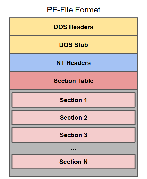

Detecting and unhooking both need the PE (Portable Executable) format, used for
.exe, .dll, .sys and the rest.
PE file — Windows binary types (.exe, .dll, .sys)
DOS Header — legacy; holds e_lfanew (offset to NT Headers)
    DOS Stub    — prints "This program cannot be run in DOS mode" on old OS
    NT Headers  — signature + FileHeader + OptionalHeader
    Section Headers — array describing each section (.text, .rdata, .idata…)
PE layout — sections and headers overview

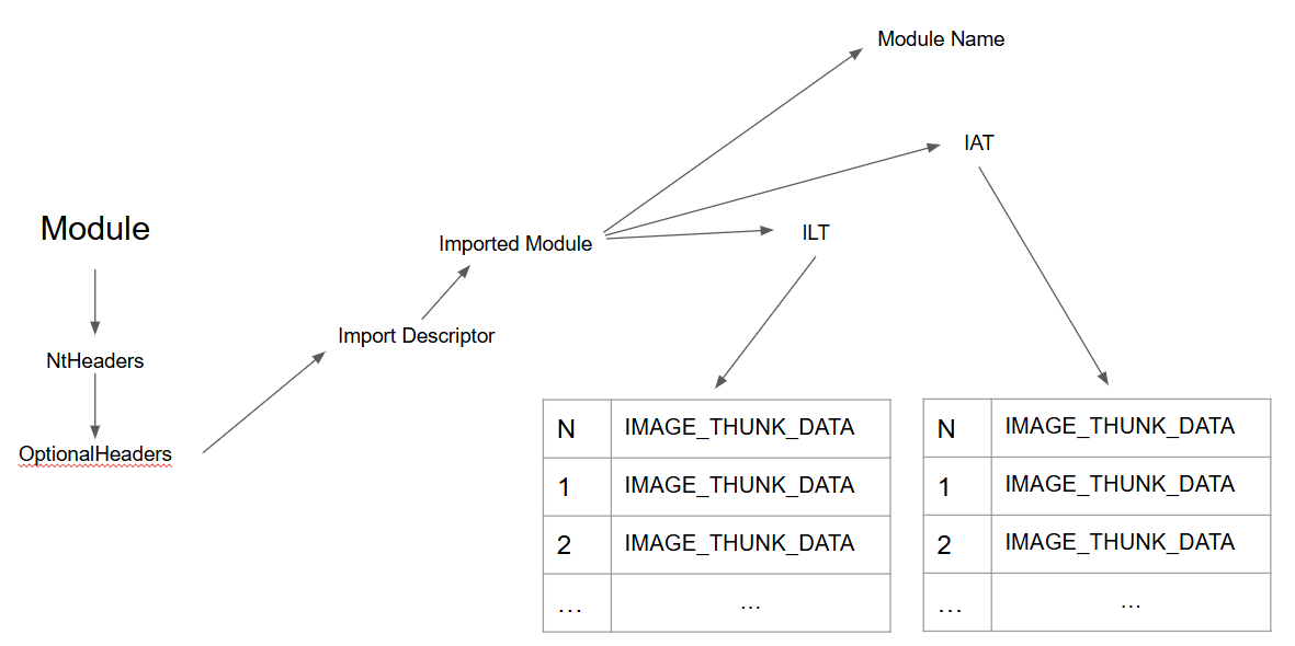

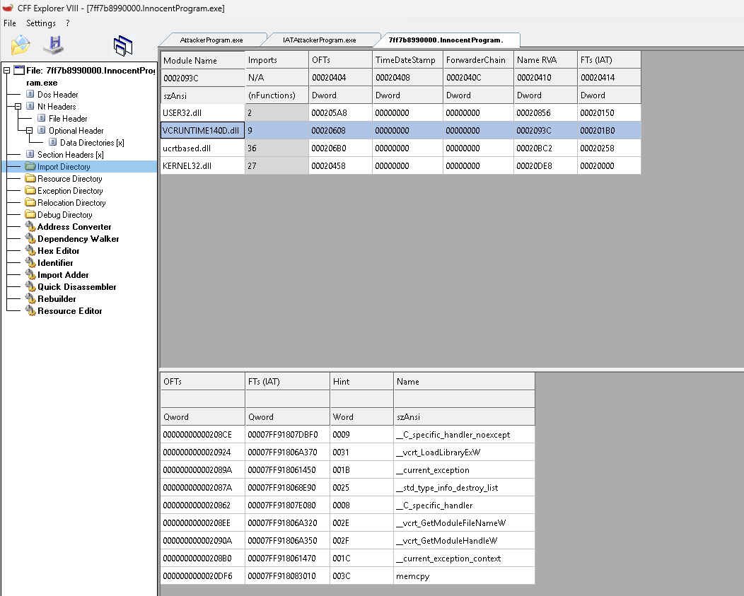

Locating the Import Directory:
    NTHeaders → OptionalHeader → DataDirectory[1] → VirtualAddress
The .idata section holds the Import Descriptor Table: one entry per imported
DLL, with two parallel arrays — the ILT (pre-resolution names) and the IAT
(post-resolution addresses).

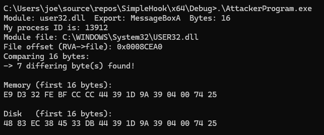

──[ 5. Detecting Inline Hooks ]──
Compare the first N bytes of a function between its in-memory copy and the
on-disk copy of the DLL. Mismatch = patched.
    // Read N bytes from memory
    HMODULE h = GetModuleHandleA("ntdll.dll");
    FARPROC f = GetProcAddress(h, "NtReadVirtualMemory");
    memcpy(memBuf, (BYTE*)f, N);
    // Read N bytes from the file on disk
    // (locate the function's RVA via the export directory,
    //  convert to file offset, then ReadFile)
    ReadFile(hFile, diskBuf, N, &read, NULL);
    // Compare
    for (SIZE_T i = 0; i < N; i++) {
        if (memBuf[i] != diskBuf[i]) { /* HOOKED */ }
The on-disk copy is authoritative — a signed DLL can't be modified without
breaking its signature. Automated detection with pe-sieve (https://github.com/hasherezade/pe-sieve):
    pe-sieve64.exe /pid <PID>
Excerpt:
    Hooked: 1
    8cea0;MessageBoxA->7ff8ed4a0178;5
pe-sieve output — hooked function detected

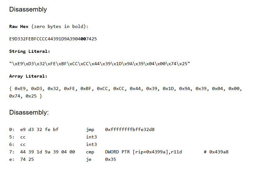

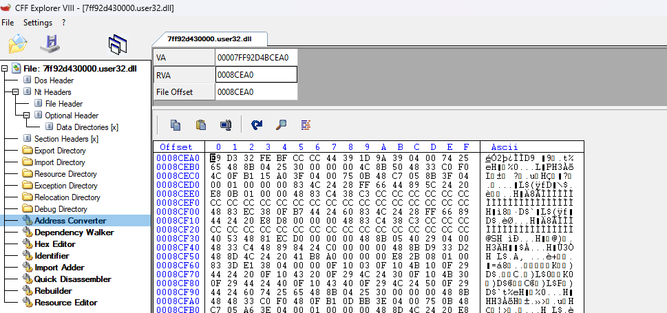

The .tag file gives the function name and the JMP target. Open the dumped DLL in
CFF Explorer, jump to the RVA, decode the bytes to confirm the JMP.
pe-sieve dump folder — .tag and dumped DLL files
CFF Explorer — RVA showing patched bytes
Online disassembler — JMP decoded to EDR address

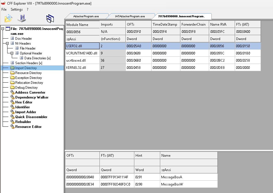

IAT structure — function pointer locations in module
Whitelist legitimate forwarders (kernelbase.dll, api-ms-* virtual DLLs, etc.) to
avoid false positives. Automated detection:
    pe-sieve64.exe /pid <PID> /iat 3
Output:
    IAT Hooks: 1
    20150;[user32.MessageBoxA #657]->7ff91330114f[...dllhookiat...]
pe-sieve IAT dump files
IAT hook in CFF Explorer — address pointing to EDR DLL
Address comparison — hooked vs normal function pointers
Owner DLL "dllhookiat" isn't user32.dll — confirmed IAT hook.
